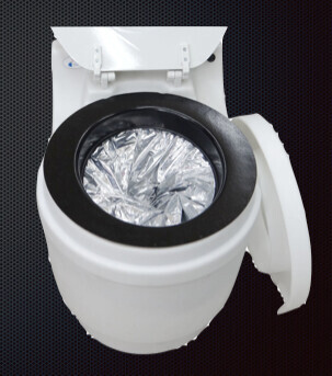

DryFlush Toilet
  • Dry Flush Toilet
  • 17 flushes per refill
  • #1 or #2
  • ~ $1.80 per flush
  • No blackwater tank, no maintenance, no smell

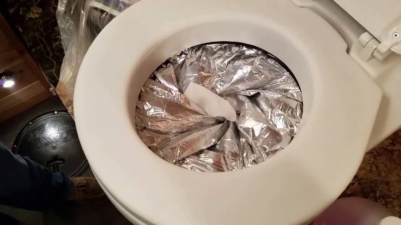

We found an inexpensive DryFlush toilet on Craigslist. It may have been inexpensive for a reason, it has failed us a few times. It had been lightly used on a sailboat for several years.
The turntable failed and when I replaced it, it was fuzzy with rust. Apparently the sald air had gotten to it. Even micro-amounts of salt air will cause corrosion over time. Next the main control board failed and I had noticed that two of the flag connectors were loose. Upon inspection, the wires uncovered by insulation were corroded.
The support from Laveo has been excellent. They offered advice over the phone and also maintain helpful videos and had us back up and running.
What makes the toilet nice is the simplicity and there is no blackwater tank. There is just the controller board, a turntable motor, a pair of fans, a cable harness, and a battery. The battery is inexpensive and can be replaced via Amazon.
The twisting motion separates every flush into its own compartment, isolating the smell. Even changing the refill cartridge is easy.
