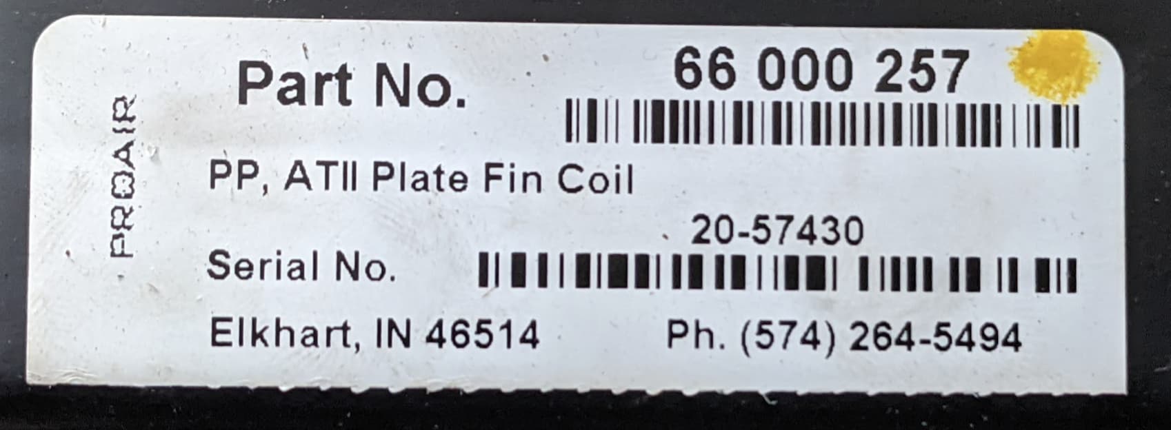

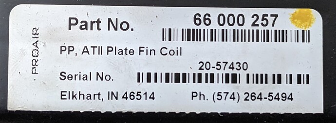

An evaporator is not included in the Trauma package
- Evaporator: ProAir Airtech II from David at Comfort Air Inc.
- $408.83 + ~$20 shipping
Evaporator
Description
- BTU: Cooling 30,000
- BTU: Heating 28,000
- CFM: 295
- 9.5 Amps @ 12 Volts
- Size: 12.18x15x9.25
- Weight: 10.5lbs

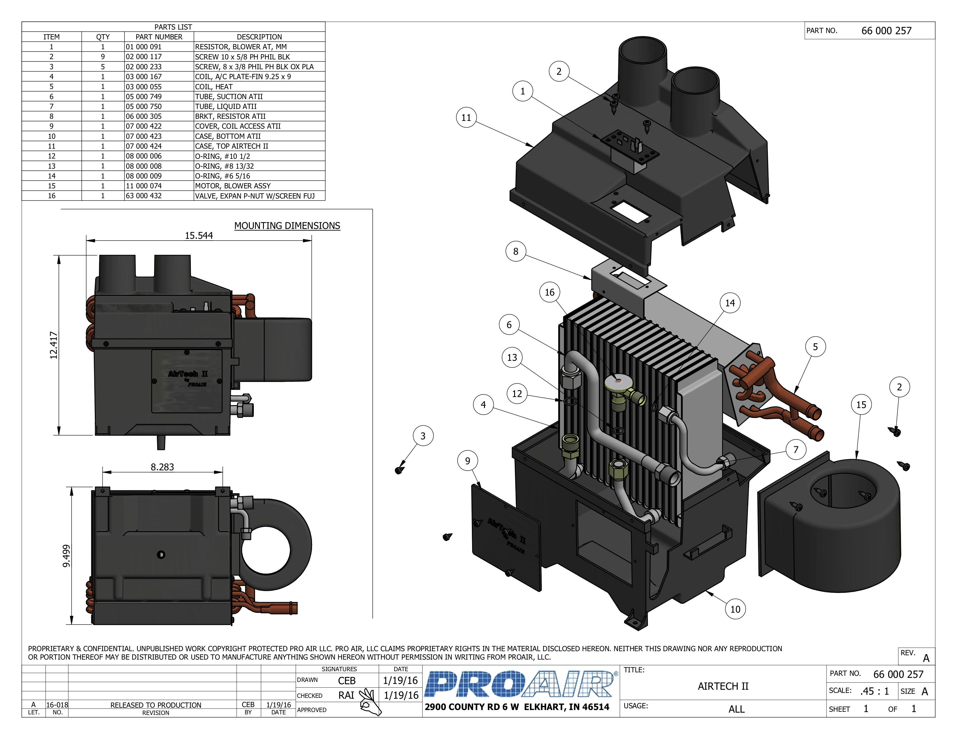

Exploded View (PDF)
Replacement Parts
Expansion Valve – 68 000 044
Coil – 68 000 065, 03 000 055
Blower – 68 000 005
Resistor – 01 000 091
ProAir Airtech II exploded view

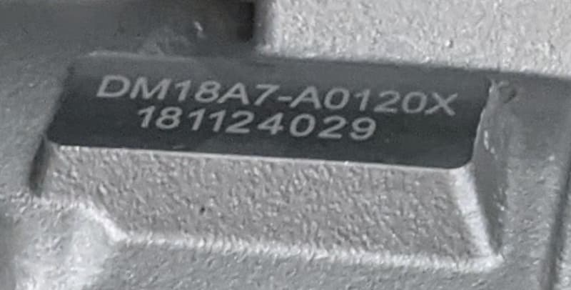

https://www.proairllc.com/109-condenser-ang/ - Benling MD18 compressor
https://benling.coowor.com/shop/product-detail/20170802103009087VFAMP1.htm
Exclusive! This is the same unit that is presently installed in Roadtrek e-Trek and Adventurous vans. This same option on the Roadtrek vans is a $4420 upgrade option.
Due to the large capacity of the evaporator and condenser used, Roadtrek claims an output of 18,000-30,000BTU at 60-100Amps @ 12VDC offering a total COP of over 2.0

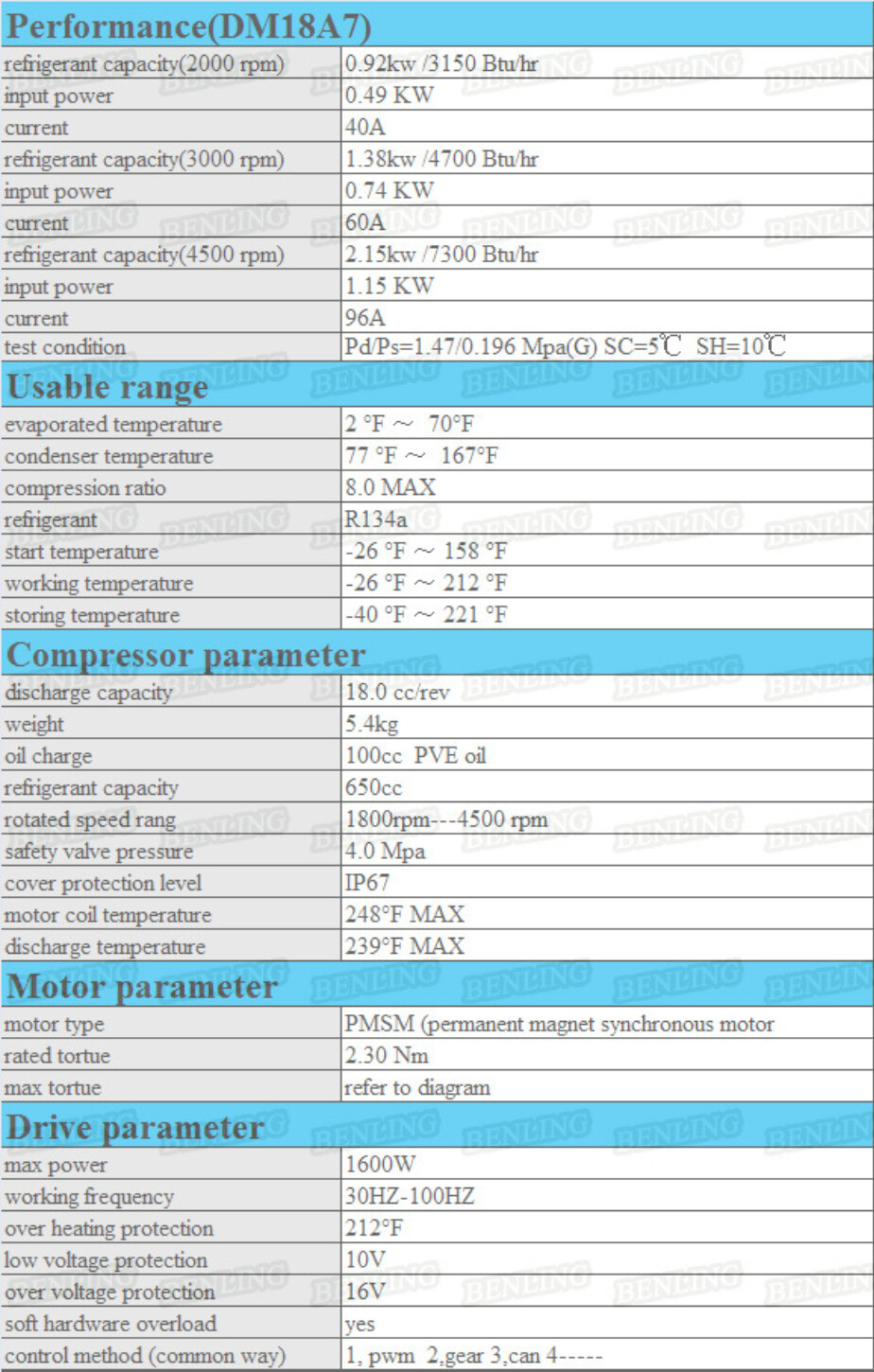

| Speed | Voltage | Amperage Low Head Pressure | Amperage High Head Pressure | Speed RPM | BTU/Hr | Kw/Hr |
| 12.0V | 20 A | 40 A | 2000 RPM | 3150BTU/hr | 0.92Kw/Hr | |
| Low Speed | 12.5V | 19.2 A | 38.4 A | 2000 RPM | 3150BTU/hr | 0.92Kw/Hr |
| Red Wire | 13.0V | 18.46 A | 36.9 A | 2000 RPM | 3150BTU/hr | 0.92Kw/Hr |
| 13.5V | 17.77 A | 35.5 A | 2000 RPM | 3150BTU/hr | 0.92Kw/Hr | |
| 14.0V | 17.14 A | 34.2 A | 2000 RPM | 3150BTU/hr | 0.92Kw/Hr | |
| 12.0V | 30 A | 60 A | 3000 RPM | 4700BTU/hr | .38Kw/Hr | |
| Medium Speed | 12.5V | 28.8 A | 57.6 A | 3000 RPM | 4700BTU/hr | 1.38Kw/Hr |
| Green Wire | 13.0V | 27.7 A | 55.38 A | 3000 RPM | 4700BTU/hr | 1.38Kw/Hr |
| 13.5V | 26.6 A | 53.33 A | 3000 RPM | 4700BTU/hr | 1 .38Kw/Hr | |
| 14.0V | 25.7 A | 51.42 A | 3000 RPM | 4700BTU/hr | 1.38Kw/Hr | |
| 12.0V | 48 A | 96 A | 4500 RPM | 7500BTU/hr | 2.15Kw/Hr | |
| High Speed | 12.5V | 46.08 A | 92.16 A | 4500 RPM | 7500BTU/hr | |
| Orange Wire | 13.0V | 44.30 A | 88.61 A | 4500 RPM | 7500BTU/hr | 2.15Kw/Hr |
| 13.5V | 42.66 A | 85.33 A | 4500 RPM | 7500BTU/hr | 2.15Kw/Hr | |
| 14.0V | 41.14 A | 82.28 A | 4500 RPM | 7500BTU/hr |
